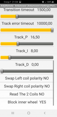

PERIMETER setting
Main value is Mag and is negative when mower is inside area (near -2000 if mower inside and upper the wire). In this case(139) the mower is outside at 3 meters of the wire.
Mini Smag:
Under this value the firmware estimate that the sender is OFF, so it's error. To find the correct value simply put the mower in the area and unplug the sender (Read the Smag and add 20 or 30 , use slider to adjust MiniSmag)
Check by start mowing and unplug the sender: Mower need to stop rapidly and go to error.
Timeout(s) if outside :
Big AREA Smag Center
Help mower to not generate In/OUT transition in the middle of big area. To find correct value ,simply put the mower in the middle area as far as possible from the wire and use Smag value.
Tracking Max Speed PWM
it's the tracking speed (lower value help to have a smooth tracking on curve)
Circle Arc Distance...
If mower find obstacle while tracking : it reverse,Roll 45 Deg and make a circle to find again the wire.
Perimeter MAG MAX VALUE
Put mower directly upper the wire and use here the maximum Mag value.
Transition Timeout
When tracking,Mower need to change from inside to outside using the PID, but if it fail after this transition time one wheel is stop to find again the wire. If too important the mower can fail tracking on 90 deg angle .
Track Error Timeout
If mower can't find In/OUt transition during this delay it's error.
Track PID
The Pid is use to smooth the tracking and need to be adjust according your platform (Distance between wheel and receiver coil,motor react speed etc..)
Coil Polarity
Do not change ,It's better to invert the wire at sender output.
Read the 2 coils
Only for dev test : Do not change
Block inner wheel
If YES the 2 wheels always roll forward , if NO one wheel can reverse to find again wire on big angle for example.
