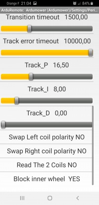

When tracking,Mower need to change from inside to outside using the PID, but if it fail after this transition time one wheel is stop to find again the wire. If too important the mower can fail tracking on 90 deg angle .
Track Error Timeout
If mower can't find In/OUt transition during this delay it's error.
Track PID
The Pid is use to smooth the tracking and need to be adjust according your platform (Distance between wheel and receiver coil,motor react speed etc..)
Coil Polarity
Do not change ,It's better to invert the wire at sender output.
Read the 2 coils
Only for dev test : Do not change
Block inner wheel
If YES the 2 wheels always roll forward , if NO one wheel can reverse to find again wire on big angle for example.
