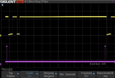

Pin out JST pin1 GND pin2 +5V pin3 Signal out (yellow line in picture) pin4 Signal in (pink line in picture, Ultra Sonic burst)
timing diagram
