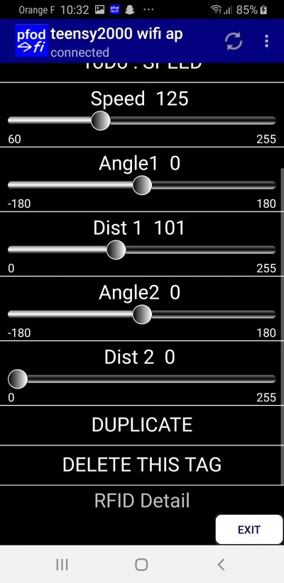

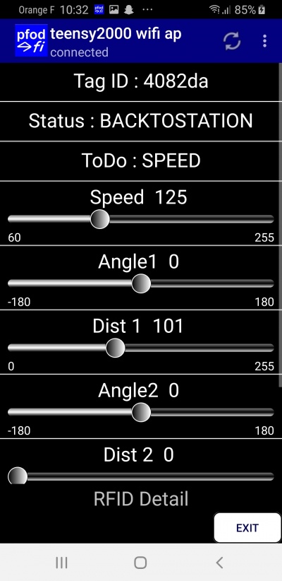

Edit a record
From RFID List ,click on on tag Nr to see the detail menu:
Now change Status, ToDo and all slider according your need:
For permanent backup hit SAVE LIST to save your change in the mower eeprom.
As 1 tag can be use for different ToDO you can use the DUPLICATE OPTION to have multiple record.
Hit DELETE THIS TAG to remove the tag from database .

Speed and Ang 1 are used
When tag 72B8DB95 is find AND mower Status is BACK_TO_STATION ,if you put RTS in the TODO column : Mower stop tracking roll 28 Degree and run at new PWM speed of 250 to find again the wire and continue tracking.
Fast Start
Can be use to go very fast from one location on the wire to other one when tracking : to reach a new area for example :
When tag 1AD8DB95 is find AND mower Status is TRACK_TO_START ,if you put FAST_START in the TODO column : Mower stop tracking roll 50 Degree and run at new PWM speed of 250 to find again the wire and continue tracking.
Change tracking speed
Can be use to Dock at low speed or simply change tracking speed when you want : ON big straight line mower can track at PWM=255 or on hard angle you can reduce the tracking speed
Speed and Dist1 are used.
When tag 4082DA95 is find AND mower Status is WIRE_MOWING , Mower continue tracking but run at new PWM speed of 80 for next 100 cm.
