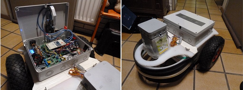

[[File:Ardumower_tower.jpg]]

  1. Install IMU module 35cm away from metal parts. Use 1m cable so you can move the module out of robot for calibration. Do no use metal parts (screws etc.) within 5cm of the module - use plastic screws. Fixate everything within 5cm of the module. A small movement of a cable etc. will make the calibration useless. Verteileraufputzdose 2017-01-22.jpg
