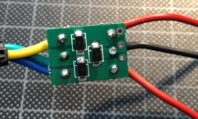

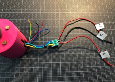

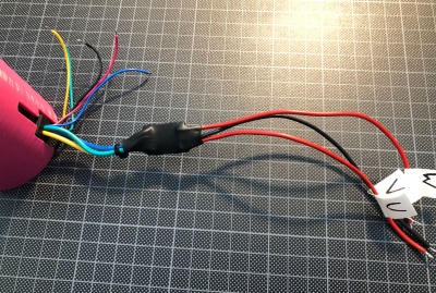

To protect the blade motor driver against the voltage from the free spinning motor we developed a TVS protection board. Solder the motor coil cable to the protection board and connect it to the motor driver board. Take care that U, V & W is connected correctly !
