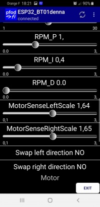

If the wheel don't roll smoothly in manual forward ,you need to adjust the RPM_P RPM_I and RPM_D
Always start with RPM_D=0 and move the 2 sliders RPM_P and RPM_I. RPM_P increase the changing speed and RPM_I smooth the speed when near the RPM max speed.
