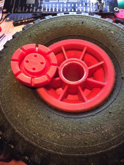

Abstract
This page describes how to modify the Ardumower Chassis to run up higher slopes with it (tested up to 30 percent). This works by
- turning the front drive into a rear drive and so requires to reverse the drive direction (so front is back and back is front)
- modifying the tire profile (give it more grip)
- Modify tire profile OR
- Off-road version (sand etc.): A bicycle tube is added around the tire
Needed parts
- cup
- acrylic glas sheet (1mm)
- rubber band
Turning front drive into rear drive
- swap motor cables (right and left)
- swap odometry cables (right and left)
- swap battery charging pin cables (right and left)
- disable ultrasonic sensor
- move perimeter coil from old front to old back side
New rubber tires
3D file (STL): https://drive.google.com/open?id=1Z5-RnOGF6VBqRKgV-_IFwwNccazjhj48
